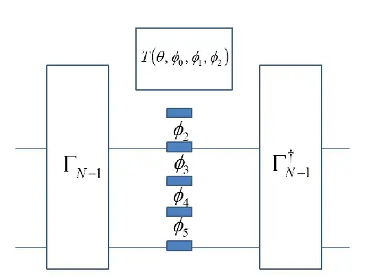

I shall give the proof of this lemma below. But for now, let's look at what the corollary says, as a signal flow graph. I have drawn it below: the general $N\times N$ unitary matrix is made up of a general $2\times 2$ unitary matrix $T_{1,\,2}(\theta,\,\phi_0,\,\phi_1,\,\phi_2)$ and two unitary $N-1\times N-1$ matrices (the one on the right being the inverse / Hermitian conjugate of the one on the left).
Unitary Matrix Decomposition
It should now be clear that there is an algorithm to build any $N\times N$ unitary matrix from $2\times 2$ unitary matrices and phase delays alone.
