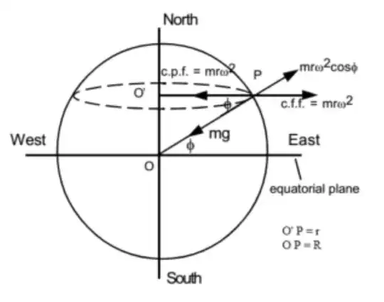

Yes and no.
No, once the body is synced with Earth's rotation, there is no need for a friction force to do work to keep the body rotating. This is what the other answer meant, I think, and is probably what you wanted to know.
However, there may exist a friction force. It is small and does not produce any work, because it is perpendicular to the body's velocity.
This force is zero on the equator and is greatest in latitude 45º. It is zero at the poles too, because at the poles the (point) body doesn't travel in a circle (zero radius).
This force exists in all points of the surface where the surface is not locally tangent to an oblate spheroid which balances this force.
To understand this force, think of Earth as a simple sphere that spins along its North-South axis. Remember that Earth's rotation makes bodies all over the surface travel in a circular motion whose center is not the center of the Earth (except when the body is on the equator). That means that the resultant force on the body is a centripetal force pointing towards the North-South axis, but not to the center of the Earth. This force's direction is on a horizontal plane secant to Earth, containing the latitude line the body is on.
However, such resultant cannot arise from the "usual forces": weight and normal are on a straight line from Earth's center to the body. So there must be a tangential contact force to "fix" the direction of the resultant. That is the friction we're talking about.
If such friction did not exist, the body would travel along a great circle instead of a latitude line.
In my (simple) calculations the magnitude of the friction force is $m \omega^2 R \sin \theta \cos \theta$ ($R$ is Earth's radius and $\theta$ is latitude).
This force is the reason why Earth is not spheric, having become (approximately) an oblate spheroid (an ellipsoid) as mentioned earlier. Earth's radius is bigger on the equator than on the poles. Research equatorial bulge for more information.
I found this pic online that helps to understand the situation.
Diagram of body on a latitude in Earth
