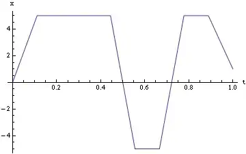

But the result appears complete nonsense. Here's the result for $n=10$, $t_1=0$, $t_2=1$, $|x_i|<5$:
Positions

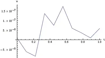

Velocities
Here velocities don't seem to reflect change in positions.
What am I missing here? Should I add some other constraints, or have I done some simple mistake?

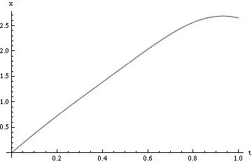

So, when I add the constraint $v_i=\frac{x_{i+1}-x_i}{\Delta t}$, specifying $x_1$ and $x_n$ remains the only additional thing to converge to the solution. For example, setting $U=x^4-4x^3+4.5x^2$, $x_1=0$, $x_n=2.651$ and $n=51$, I get:
Positions:

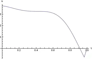

Velocities:
Here the last point of velocity is wrong, but it's an artifact of the constraint: I've used a right-hand finite difference derivative, which can't be done for $v_n$. This can be fixed by choosing some other difference scheme, but for the purposes of this answer it's an unimportant implementation detail.
What's more important, is that if we choose $x_n>2.651$ in this example, the action appears unbounded from below even with the correct constraints. I believe this is no longer a problem in the implementation, but rather a result from the fact that the action just has to be stationary, but not minimal, so minimization is not a good enough procedure to obtain a true trajectory.
