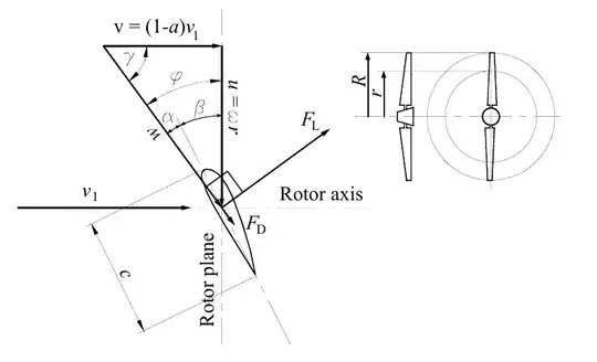

In this picture $v_1$ is wind speed at far upstream, $v$ is wind speed at rotor (wind speed is different at upstream and downstream and it has some intermediate value at rotor), $u$ is linear velocity of the blade. $w$ is the apparent wind speed (wind speed relative to the blade). The apparent wind is stronger than the true wind but its angle is less favourable. You see that when rotating, angle of attack $\alpha$ is close to zero. A flat plate at zero angle of attack produces nothing but drag, while an airfoil can produce considerable lift even at zero angle of attack (while cruising wing of an airliner has almost zero angle of attack).
The lift $F_L$ has a component along rotor plane which contributes to a positive torque along the rotor axis, while the drag $F_D$ has a component along the rotor plane tends to decrease that torque. That's why we should decrease the drag.

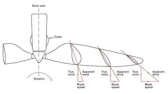

The closer to the tip of the blade you get, the faster the blade is moving through the air and so the greater the apparent wind angle is. To compensate for this they twist the blade.

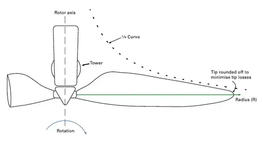

The planform shape is chosen to give the blade an approximately constant slowing effect on the wind over the whole rotor disc (i.e. the tip slows the wind to the same degree as the centre or root of the blade). This ensures that none of the air leaves the turbine too slowly (causing turbulence), yet none is allowed to pass through too fast (which would represent wasted energy).
Because the tip of the blade is moving faster than the root, it passes through more volume of air, hence must generate a greater lift force to slow that air down enough. Fortunately, lift increases with the square of speed so its greater speed more than allows for that. In reality the blade can be narrower close to the tip than near the root and still generate enough lift. The optimum tapering of the blade planform as it goes outboard can be calculated; roughly speaking the chord should be inverse to the radius.
In reality a fairly linear taper is sufficiently close to the optimum for most designs, structurally superior and easier to build than the optimum shape.

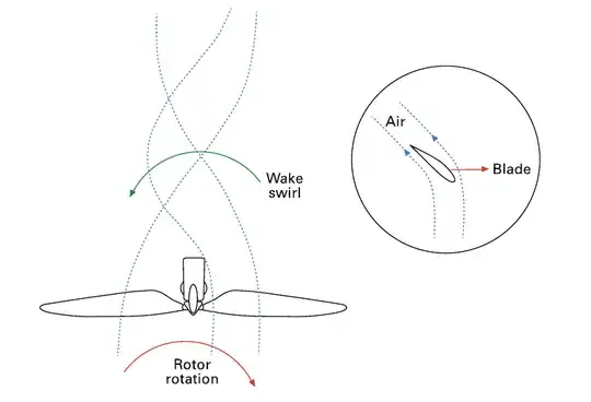

Furthermore remember that the equal and opposite force is exerted on the fluid. As the blades generates torque, they would have an equal but opposite effect on the air. So the air downstream would have a swirl. That swirl represents lost power so reduces the available power that can be extracted from the wind. Lower rotational speed requires higher torque for the same power output, so lower blade speed results in higher wake swirl losses.
