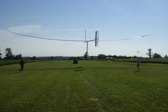

Human powered flapping-wing aircraft (ornithopter)
It seems this couldn't take off under human power alone but, once airborne, could produce enough thrust to overcome drag for up to 145 meters in 20 seconds of flight.
to achieve flight on the limited power of the human engine, the aircraft must be designed to fly quite slowly. At these slow speeds, the wing must be incredibly large to produce the required lift, and the structure must be incredibly light. To help support the light structure, external wire bracing is typically used, and although these wires add drag, the weight savings in the structure is significant. This wire-braced structure favours a hanging fuselage design, which is typical for human-powered aircraft. In the case of a human-powered ornithopter, the bracing wires are additionally used to pull the wing down during the thrusting portion of the stroke.

So far, most human-powered flights seem to rely mostly on leg muscles.
