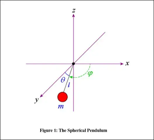

For a simple example of a 3-dimensional (actually 2-dimensional, since the configuration space is the surface of a sphere) hamiltonian system which is completely integrable, see the spherical pendulum and analysis thereof
spherical pendulum
The spherical pendulum is 2-dimensional system (thus the phase-space is 4-dimesnional) and has a second integral of motion the moment about the vertical axis.
(a link on a more advanced analysis on the dynamics of pendula).
