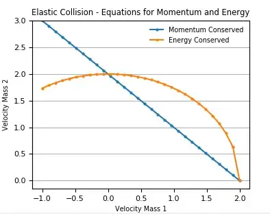

Solving the simultaneous equations got very messy very quickly, so I plotted the equations for a theoretical mass of unit one and velocity=2 colliding with a identical stationary mass in a single dimension (perhaps carriages on a rail, or perfectly straight collision of billiard balls). The plots show the results, post collision, for the velocities of mass 1 ( x axis) and mass 2 (y axis), under conservation of momentum and conservation of kinetic energy. The only possible solutions must satisfy both, thus we examine the intersections:
mass 1 and mass 2 equal
There are as expected two solutions, one impossible, in which mass 1 essentially passes through mass 2 unimpeded, with no effect on mass 1 (velocity mass 1 = 2, velocity mass 2 =0), and the other (and only feasible solution) with mass 1 stopping and imparting its full momentum to mass 2, which now moves away with velocity 2 (think of the white cue ball stopping dead when hitting another ball full on).

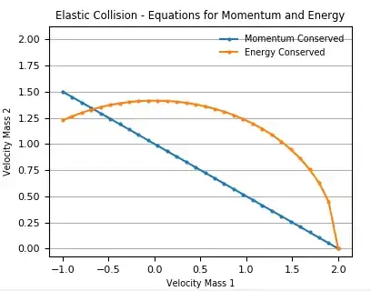

Now, if we consider the case with mass 2 twice that of mass 1: mass 2 twice mass 1
We see the feasible solution is that in which the lighter mass 1 rebounds off heavier mass 2 (mass 1 velocity ~ -0.65, mass 2 forward at ~ 1.3). Clearly, any case in which mass 1 is lighter will see it rebounding to some degree, and mass 2 being propelled forward. So there is no possibility for $m1 < m2$ in which they can merge with the same velocity.

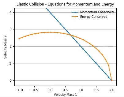

Looking at the opposite case, with $m1 > m2$, in this case mass 1 double that of mass 2: enter image description here
We now see mass 1 retaining positive momentum (velocity ~0.65) and mass 2 shooting off rapidly (velocity ~2.7). From this, we can deduce that for any $m1 > m2$, m2 will achieve velocity >2, and the original mass 1, having imparted some momentum to mass2, will retain velocity within bounds #0< v2 < 2$. Again, there is no solution of any two masses satisfying conservation of both momentum and energy which allows the two masses to do anything other than "bounce off" each other two some degree - which is I suppose what you might infer from an elastic collision!
