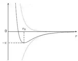

Consider the figure below showing the effective potential (continuous line) of a particle of mass $m$ and angular momentum $L$ under the gravitational force $-GMm/r^2$, enter image description here
The circular orbit of radius $r_0$ correspond to the minimum mechanical energy $-\epsilon<0$. To perturb this orbit means to add a small mechanical energy so that the orbit is limited between $r_{min}$ and $r_{max}$. As long as this increment is small (the total mechanical energy is lesser than zero) the resulting orbit is an ellipse. The perturbation may be due to the gravitational attraction of the dust distribution you mentioned.
In this post of mine I show step by step the precession rate for a perturbed orbit around the circular orbit. This rate is $$\Omega=\frac{-\sqrt{F(r_0)}-\sqrt{-3F(r_0)-r_0F'(r_0)}}{\sqrt{mr_0}},$$ where $r_0$ is the radius of the circular orbit and the force $F$ is decomposed into the main contribution $F_0$ and the perturbation $F_p$, $$F=F_0+F_p.$$ If $\Omega>0$ then the ellipse axis precesses counterclockwise. In your case, $$F_0=-\frac{GMm}{r^2},\quad F_p=-mkr.$$ Plugging into $\Omega$ one gets $$\Omega=\frac{\sqrt{-F_0(r_0)-F_p(r_0)}-\sqrt{-F_0(r_0)-4F_p(r_0)}}{\sqrt{mr_0}}.$$ Taylor expanding up to first order around $F_p/F_0$ gives $$\Omega=-\frac{3}{2}\frac{F_p(r_0)}{\sqrt{-mr_0F_0(r_0)}}=\frac{3}{2}\sqrt{\frac{m^2k^2r_0^2}{GMm^2/r_0}}=\frac{3k}{2}\sqrt{\frac{r_0^3}{GM}}.$$
