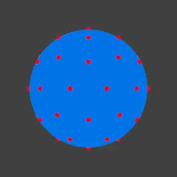

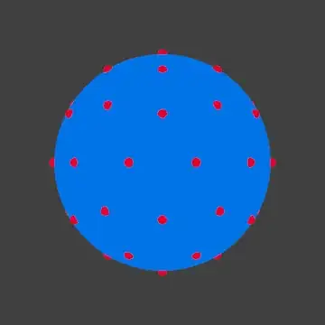

Made visualisations so you can see how it looks like.
Rotating X:
Rotating X and Y:
Rotating X,Y and Z:

There is not a simple answer for this since it is both yes and no.
From an internal frame of reference:
Looking at the object, nothing is happening.
Looking at the outside world, it is moving in a predictable pattern.
From an external frame of reference:
The rotation on one axis is easy to see.
The rotation on 2 axes looks like a rotation on a moving axis.
The rotation on 3 axes is difficult to describe.
