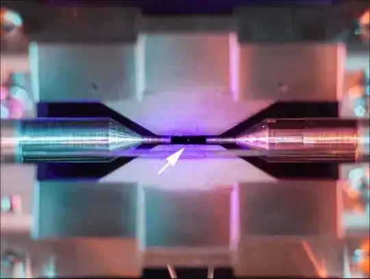

Yes, a single atom/ion can be visible with the naked eye, and a photo of a single Strontium ion is shown below to demonstrate what this looks like (image from here).
This photograph was taken by David Nadlinger, a scientist at the University of Oxford who stated, "The idea of being able to see a single atom with the naked eye had struck me as a wonderfully direct and visceral bridge between the minuscule quantum world and our macroscopic reality." This image won The Engineering and Physical Sciences Research Council's 2018 National Science Photography Competition.
I see no reason why not. As the answer from Emilio argues, it's not hard to get scattering rates in the millions of photons per second. To take this a step further, suppose you put your head around 10cm away from the light source to get a good look. With a 3mm aperture in your eye, you'd collect $$ \frac{\pi(3*10^{-3})^2}{4\pi(0.1)^2} = 0.000225 $$ of the light, or if you're scattering order 10 million per second, $0.000225\times10^7=2250$ photons, which should be a good deal above the threshold for your eye even after dividing by a factor appropriate for the frame rate of your eye. Of course use any magnifying glass and this quickly gets much easier.
