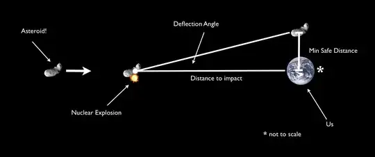

EDIT:
Here is a diagram given to help illustrate the problem I am to write the code for.
The inputs for the program are:
  • the asteroids velocity,
  • diameter (assume its a ball),
  • type ( from type we estimate density and from there mass).

A "collision course" is a very fuzzy concept: if you are "barely going to hit" you are on a collision course but don't need a lot of deflection. However, let's assume for a moment a stationary earth, a meteorite of mass $m$ at distance $D$, heading for earth of radius $R$ with velocity $v$.
The equations you need are conservation of angular momentum and energy. If you give the asteroid a lateral kick $F\Delta t$ (impulse = change in momentum $m\Delta v$), then the angular momentum of the new orbit is
$$L = m \Delta v \cdot r$$
And this will still be the angular momentum when you reach earth. So the question then becomes, what velocity will it have when it gets to earth? The answer - at a distance of $3R$ it will have increased its velocity (because of the gravitational potential energy it had). Assuming you started very far away ($r>>R$) you find this from
$$\Delta E = \frac{GmM_e}{3R} = \frac{gmR}{3}$$
since we know that the gravitational acceleration of the earth at the surface, $g$, is given by
$$g = \frac{GM_e}{R^2}$$
Finally, kinetic energy is $\frac12 m v^2$ as you may remember. So velocity will increase when energy increases.
I'm going to leave you the fun of combining these equations to solve your problem. I must admit I am a little bit unsure of how you plan to model the explosion - you might want to elaborate a bit on that if you need help figuring out the impulse $F\Delta t$.
