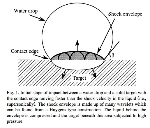

An example is the impact of a drop of water with a surface. During the early phase of the impact, the curved front of the drop is flattened as it hits the surface; during this phase the contact point between the drop and the surface travels supersonically, meaning that the shock wave that builds up inside the drop remains attached to the contact point, and the pressure inside the drop builds up considerably (source: "ELSI conference: invited lecture Liquid impact: theory, experiment, applications", JE Field, Wear 233–235 1999 1–12):

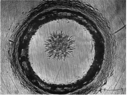

As the contact point slows down when the contact angle increases, the pressure eventually can escape, resulting in a jet of water across the surface which creates terrific shear stresses. This results in a very characteristic damage shape:
This particular example is for plexiglass (polycarbonate) which is a great material for studying the subsurface cracking - but the same thing happens with harder material. Source of the above image: http://blog.kmt-waterjet.com/category/waterjet-technology/ . If you are interested in learning more about this, consult the proceedings of the ELSI conferences that were held in Cambridge (UK) during the 80's and 90's (Erosion by Liquid and Solid Impact). A good start would be the above referenced lecture by Dr JE Field who was the conference's organizer.
So yes - if your definition of cutting is broad enough to include "able to remove material", then a soft material can cut a harder one.
