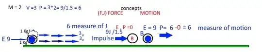

In order to give a comprehensible answer to the question, some historical background is indespensable: you can see here that there is no Newton second law and that force equal to $ma$ was a 'law' defined some two century later, when force was also modelled after gravity and work after the lifting of buckets from mines, against gravity. Keeping this in mind we can examine what happens in these formulas and why it happens. $$F = ma; W = [F . d] = E; J = [F . t] = \Delta p$$
As you may have read in the link, Newton made already a distinction between 'motion' and 'measure of motion' = momentum, and this is a first difference, but there is another more fundamental difference, which we might call of 'category', between the left and the right side of the equations: the 'concept' on the left indicates a 'cause' and the one on the right its 'effect'.
What is it all about? Energy, the transfer of energy from A to B, that is the bottom line, and, when you give (kinetic) energy to a body you are giving it, at the same time, velocity/momentum, as we are talking, here, about impulse and collisions. In the case of work the effect, the 'concept' involved is directly,energy as its measure is in joules, which is useful for all kinds of energy and, therefore, also when work is done against a force and gives no momentum.
In the case of impulse, momentum has been chosen, preferred for various reasons but nothing forbids you to choose 'energy' also in this case.
Let's try to make it even clearer. Consider the definitions (from wiki, the arrow shows the direction of transfer):
  • $F$ : a force can cause an object with mass to change its velocity (which includes to begin moving from a state of rest), i.e., to accelerate, hence $F = \rightarrow E_k$
  • $W$ : work is the energy associated with the action of a force, a force is said to do work when acting on a body there is a displacement, hence $[F.d] = E . d \rightarrow = \leftarrow W = \leftarrow E$
  • $J$ : impulse is the product of a force, F, and the time, t, for which it acts. The impulse of a force acting for a given time interval is equal to the change in momentum. $[F.t] = J = \rightarrow p$, since $p * v/2 = E_k$ , then $$[E_k .t] \rightarrow = \frac{E_k}{v/2} J \rightarrow = \leftarrow \frac{E_k}{v/2} \rightarrow p$$
Keep also in mind that in collisions the formula F.t is a pro-forma as time is usually considered istantaneous. One of the reasons of the choice of this formula is that what we know in collisions is v, velocity of cue ball A (= 3m/s) and m, its mass (= 2Kg), therefore it is easier to get momentum (= 6) and assume that the same amount will be the change of momentum of ball B.
In conclusion, what is the answer? Impulse is the cause and (change of) momentum is the effect (of the second order) of a transfer of energy, impulse is a 'concept' = force', momentum is the measure both of 'motion' and of impulse' : energy (J) , momentum (2E/v kgm/s) transferred from A to B. A possesses energy/momentum which, the moment it is 'donated' becomes force/impulse of force, when it is 'received' by B, is called work done/energy transferred/change of momentum. The moment ball B meets a ball C its (change of) momentum becomes itself an 'impulse'.
