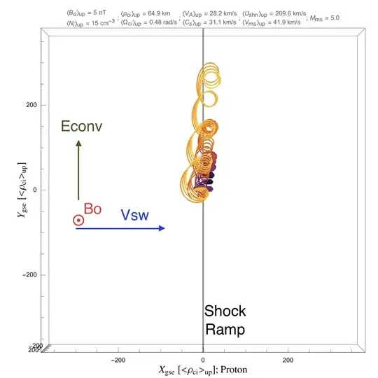

I wrote a simple Mathematica routine to simulate this with numerous test particles with different initial trajectories (see image below). The particles that undergo multiple reflections gain more energy than those that are transmitted into the downstream after one (or zero) reflection(s), which is evidenced by the larger gyroradii of the particles with increasing distance along $+\hat{\mathbf{y}}$. Example test particle simulation
The above image is an example of something called shock drift acceleration (SDA), where shock-reflected particles gain energy while skipping along the upstream edge of the shock front from the convective electric field. This is not to be confused with diffusive shock acceleration (DSA) (or first order Fermi acceleration) whereby particles gain energy by reflecting off of merging magnetic mirrors. A nice animation of SDA can be found at https://svs.gsfc.nasa.gov/4513.
