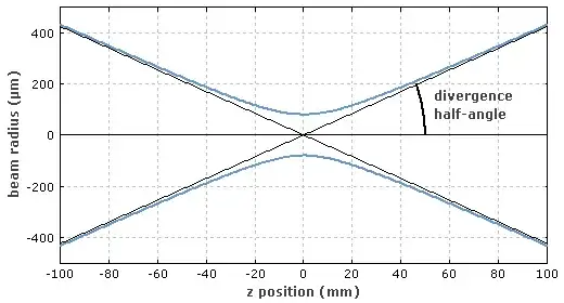

A Gaussian beam is a beam where if you shine it on paper, the intensity has a Gaussian distribution. Easy enough. The Divergence half-angle is the angle it's diverging at, given a few qualifiers, from http://www.rp-photonics.com/beam_divergence.html
divergence and far field
Far field is a point far to the right on this image where the width of the beam is close to the black lines. Some other mechanism prevents it from converging at a point in the middle because, of course, we could have already dismissed that as theoretically impossible.

There is a limit to how small you can focus an ideal single-mode laser beam. The product of the divergence half-angle $\Theta$ and the radius $w_0$ of the beam at its waist (narrowest point) is constant for any given beam. (This quantity is called the beam parameter product, and is related to the $M^2$ beam quality measure you may have heard of.) For an ideal Gaussian ("diffraction-limited") beam, it is:
$$\Theta w_0 = \lambda/\pi$$

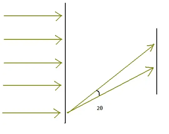

Below is my illustration of a beam of 100% collimated rays (I'm talking about Newtonian physics here), and the first vertical line is some hypothetical perfect lens, that would converge perfectly on the next vertical line. If the rays coming in were perfectly collimated then the rays would exactly converge on a single point, but we know they don't because of the divergence angle.
laser focusing
  • Beam radius is 0.6 mm
  • $2 \Theta = 0.001 rad$
Again, I'm going to act like a high school physics student, pretend I don't even know what wavelength is, and use geometry. I'll assume the angle the furthest beams are deflected at is 45 degrees, and denote the things about the area it focuses on as $dot$.
$$r_{dot} = (\sqrt{2} \omega_0) (\Theta) \sqrt{2} = 0.0011 mm = 1.1 \mu m$$ $$A_{dot} = 1.21 \mu m^2$$
