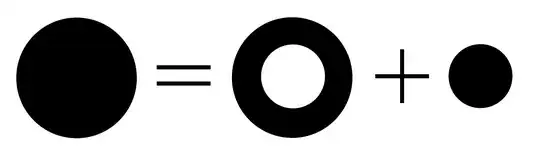

Suppose you have a solid sphere of mass $M$ and radius $R$ and a smaller mass $m$ at a distance $r<R$ from the centre.
Note that a solid sphere is equal to a smaller solid sphere of radius $r$ plus an outer shell:
The force from the outer shell is zero, and the force from the inner sphere is $$ Gm\left(M\frac{r^3}{R^3}\right) \frac{1}{r^2}$$
