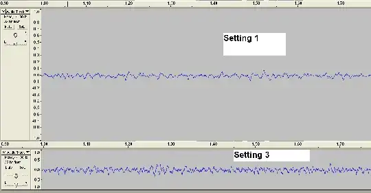

The fan has 3 settings, plus 0 for off. Setting 1 is the slowest and setting 3 is the highest. It produces quite a good breeze and has served me well. To start off, I'll share a waveform I recorded with it on setting 3 and setting 1 with me doing nothing else to it.
Waveform for 1 and 3 settings with no pen
As you can see, this is not too useful. It makes a sound, but there's no way to distinguish peaks. Maybe it has a frequency that reflects the speed of the fan, but I can't be sure (and I haven't had much luck with the spectrum visualizations). You can see how the sound it makes is different between the two, and the 3rd setting is obviously louder, and the frequency is obviously different, but we want actual numbers.

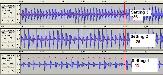

So I put a plastic pen in it (the butt of the pen). Now, you might not want to try this at home (like I just did), but I kind of had to play with the angle to get it to not miss blades. It's very easy for it to jump and miss one, which would mess up the count. I had to press kind of hard and it was rather loud. But I got results. Here are the waveforms for 0.5 seconds, and my markup in order to count the "hits". I also provide the actual count in the image.
Waveform with markup
You can check my work for the count itself. I'm also happy to upload some mp3 files, but I'm not sure where I'll host them right now. The above image was made with the high-tech research software MS Paint. I'll give answer denoted $rpm_i$, where $i$ is the number of the setting, and the number of hits above will be denoted $hits$. I'll take the error in each hit count to be $\pm 1$ hit. The formula and reported results are as follows. Remember, it has 5 blades.
$$rpm_i = \left( hits_i \pm 1 \right) \times \frac{turn}{5 hits} \times \frac{1}{0.5 s} \times \frac{60 s}{min}$$
$$rpm_1 = 456 \pm 24 rpm$$ $$rpm_2 = 624 \pm 24 rpm$$ $$rpm_3 = 864 \pm 24 rpm$$

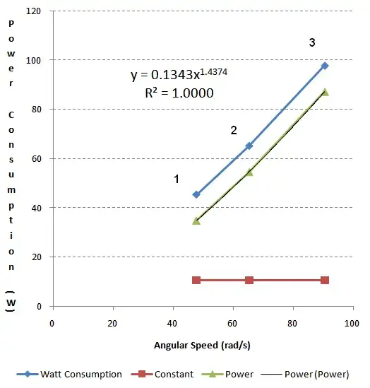

I used my KILL A WATT device to record power consumption for all the different speed settings. I'll denote this with $P_i$ but I need to explain a little about the difficulty in making this measurement. I believe my KILL A WATT to be fairly reliable and it gives stable power measurements for devices with constant power consumption. This is not quite true for the fan. When I first turn on the fan it consumes more power than after I leave it running for some time. The largest swing I observed was $50.5 W$ at max and $45.3 W$ at minimum for setting 1. This gives you another possible source of error. Since the experiment was performed with the fan on for a good while I'll report the lowest readings I have.
$$P_0 = 0 W$$ $$P_1 = 45.3 W$$ $$P_2 = 65.1 W$$ $$P_3 = 97.1 W$$
Now, I want to take just one quick second to apply the physics concepts of friction here. Dynamic friction between two solid bodies is often taken as a constant, and fluid friction is often taken as a power law, as in, $v^n$ where $n$ is most commonly from 1 (fully laminar) to 2. We can apply that here! I converted the previous speeds to rad/s and plotted the speed versus power consumption for all 3 "on" settings. Then, I guessed a certain offset and subtracted this value from the power consumption and applied a power fit to what was left. I realized after I did this that a constant power consumption does not correlate to a constant force (that would be linear), so I'm really just assuming some base power consumption for the device, and this yields a more perfect power fit for what's left just due to the mechanics of the motor. I found that I could get a better power fit by making this subtraction. The power fit had $R^2=1.0000$ for a constant offset from $8 W$ all the way to $13 W$ so I took the middle ground of $10.5 W$, which is to say, I made an educated guess that a constant power loss accounts for $10.5 W$ out of the consumed power. The power fit follows a satisfying $1.5$ power law, which is about what I expect for fluid friction.
Power consumption, broken down into static and fluid friction
$$P_i = 10.5 W + 0.1343 \omega_i^{1.4374} W$$
