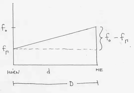

Suppose the horn is moving towards the observer. As the distance between the source and the observer changes lineally with uniform velocity, the change in frequency with respect to distance travelled should also be lineal as follows:
Let $D$ be some arbitrary distance from the source (horn) to the observer (me)
Let ${f_\Gamma }$ be the apparent frequency of the horn at distance $D$ from the observer, while it is moving with uniform velocity.
Let ${f_o}$ be the frequency of the horn in its own inertial frame (i.e. rest frequency).
Let $f$ be the apparent frequency at some particular distance travelled (i.e. $d$).
Using the y-intercept form of a line,
$y = mx + b$
then $$f = md + {f_\Gamma }$$
$$m = {{({f_o} - {f_\Gamma })} \over D}$$
$$f = \left( {{{({f_o} - {f_\Gamma })} \over D}} \right)d + {f_\Gamma }$$
$$f = \left( {{{({f_o} - {f_\Gamma })} \over D}} \right)vt + {f_\Gamma }$$
If the horn is moving away, then
$$f = \left( {{{({f_\Gamma } - {f_o})} \over D}} \right)vt + {f_o}$$ If I've made a mistake, please let me know. I can't afford a lab to verify this myself.

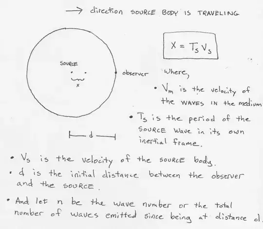

As such, enter image description here
Thus in general, the time it takes for pulse $n$ to get to the observer is given by,
$${t_n} = {{d - (n - 1)x} \over {{V_m}}}$$ $${t_n} = {{d - (nx - x)} \over {{V_m}}}$$ $${t_n} = {{d - nx + x} \over {{V_m}}}$$ $${t_n} = {{d + x - nx} \over {{V_m}}}$$ $${t_n} = {{d + x(1 - n)} \over {{V_m}}}$$ and since $$x = {t_s}{v_s}$$ then, $${t_n} = {{d + {t_s}{v_s}(1 - n)} \over {{V_m}}}$$
Here it shows that for every pulse, the time it takes to reach the observer is decreasing, thus the wave period recorded by the observer is decreasing and thus the frequency, the observer records, is increasing.

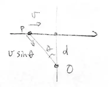

For the derivation, see the following diagram, and find an expression for the relative velocity $v\sin\theta$ as a function of time, the substitute into the classical Doppler equation.
The key step to note is that the velocity towards the observer, $v\sin\theta$, can be found from
$$v_{relative}=v \sin\theta = v \frac{vt}{\sqrt{(vt)^2) + d^2}}$$

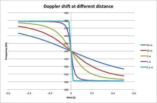

Here is a plot of the above equation for a few different values of $d$, the closest distance. As you can see, when the object is coming "almost" straight at you (10 cm closes approach), the frequency (nominally 440 Hz) shifts "instantly" (limited by time resolution of the calculation):
Rewriting the Doppler equation for $d=0$, you get simply
$$f' = f\left(1-\frac{v \text{ sign}(t)}{c}\right)$$
To understand this intuitively, you need to think about the fact that when the source is heading straight towards the observer, the amount by which the distance decreases per unit time is the same. So the next wave is emitted from "closer up", which is why it arrives " a little bit sooner than expected from the frequency". But at that point you can reset your timer, and the next wave again arrives "a little bit sooner than expected" - in other words, each crest arrives "too soon", but by the same amount. That is why the pitch does not change as the source gets closer in the case of the head-on trajectory. For any other trajectory, the component of velocity of the source towards the observer decreases as you get closer, and the pitch gradually decreases.
