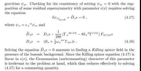

Here's an excerpt from https://arxiv.org/abs/hep-th/9803116 by K.S Stelle.
sugra transform
Here $\epsilon$ is the supersymmetry parameter, $\psi$ is the gravitino, $F$ is an antisymmetric 4th rank tensor, $e$ is a vielbein, $\omega$ is the spin connection and the $\Gamma^{AB...}$ are products of Dirac gamma matrices. This makes $D_A$ the covariant derivative of a spinor.
The condition for a Killing spinor is that the right hand side of (4.17) vanishes. Note that when $F=0$ this reduces to $D_A\epsilon=0$, i.e. $\epsilon$ is covariantly constant. Mathematicians call this a parallel spinor. For them a Killing spinor satisfies $D_A\epsilon = \lambda\Gamma_A\epsilon$ for some $\lambda$.
