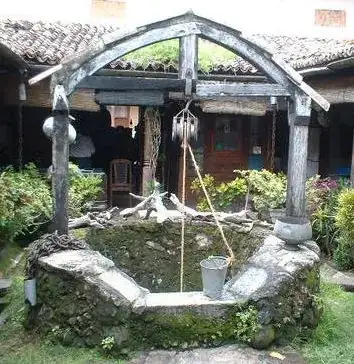

This also happens in mechanical systems. A practical example would be a well which has bucket attached through a rope
Over years of usage and several runs of different ropes the pulleys and other structures get damaged. To prevent this lubrication and greasing is used, and surfaces are also polished from time to time.
