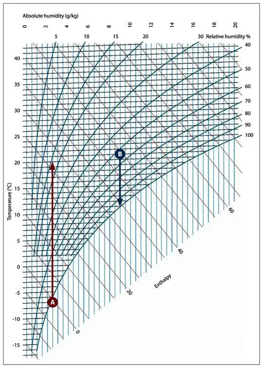

The practical answer is here: https://www.ncbi.nlm.nih.gov/books/NBK143947/
The example of usage : point A $-8^\circ$ C, 100% rel. humidity outside will end up with 15% humidity inside when reheated to $20^\circ$C.
