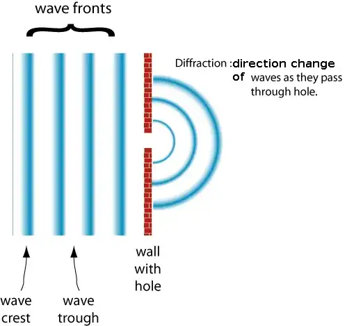

I know that waves diffract around a slit and this is due to the Huygens-Fresnel principle. But I never understand this in an intuitive wave that why does a wave become a spherical wave front at the slit? Huygens principle gives all the math behind this but does not actually explain that why does a wave bend round the edges.
Some might say that this happens because this a property of a wave that it forms a spherical wave front and the final wave is a result of superposition of those wave fronts. I know that, but it would be great if anyone could come up with an intuitive approach to this and actually explain why waves diffract or why do they form a different wave front at the slit. This question might be somewhat similar to, why do waves bend around corners.
Image source: https://www.ph.utexas.edu/~coker2/index.files/Diffraction.gif

I think you are looking at the question in a slightly backwards way. It would be better phrased as: Why is it possible to have plane waves?
In physics all point sources, wave sources which are smaller than the wavelength, generate outgoing spherical waves. As an example consider throwing a rock into a pond; the outgoing waves are emitted equally in all directions. Generating a plane wave, such as you have at the input of your image, requires taking many of these point sources and exciting them coherently such that their individual spherical waves add up to form a plane wave travelling in one direction. In the water example this can be done by moving a large flat surface back and forth which creates an infinite number of point sources along its surface.
Diffraction is the opposite of this. You've managed to generate a plane wave by coherently combining a bunch of point sources. Now you block the plane wave except at a gap which is comparable to the wavelength, and in doing so you extract one of the spherical waves which was generating the plane wave.

At the hole in the wall though, the molecules inside the hole will logicaly start moving up and down. In turn their neighbours will do the same. The neighbours in the direction parallel to the waves won't be at the same height as them though. (since the wave can't get through a solid wall.) So this situation ends up looking a lot like example with the one intially moving molecule, which resulted in circular waves. And that's exactly what will happen.

The wave propagates in the direction perpendicular to the surface of the wave front. The bit of the wave front that passes through the hole now has a surface on all sides, so it propagates in all directions.
Why does the wave propagate perpendicular to the wave front? Because waves are caused by restoring forces that smooth out differences - if you pull a bit of taut string up, it snaps back down to be closer to the adjacent bits of the string. The wave front is the surface along which the amplitude of the wave is equal, so there's nothing to smooth out and no forces in that direction. The forces propagating the wave are all perpendicular to the wave front, along the amplitude gradient.
