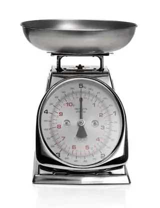

My nephew is 3 and weighs around 30 pounds I am guessing. However, I would like to weigh him at home. I have kitchen scales, one flat one that goes up 1kg and one that looks like this picture that goes up to 5kg. enter image description here
What is a safe and practical way I can weigh my nephew at home?

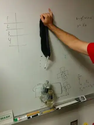

Sock scale
In the interest of science, I'll also report a method that I don't recommend. I was trying to think of an elastic medium that you would have access to in your home, which you could use to weigh your nephew incrementally. If you could imagine calibrating a single spring to a small mass, then you could use many such springs to measure your nephew. What spring-like material does everyone have access to many copies of? Socks! So, in the interest of science I took off my two socks and tried to see if socks have a hookian enough response to be useful.
Experimental setup:
Experimental Setup
I used two socks, a binder clip to secure the weights to it, a pen, some string, and multiple 20 fl oz ( = 1.3 lbs of water ) bottles, and tried to see if the response was hookian over several bottles. I got
1 bottle  -- 1.5 distance units
2 bottles -- 2.8 distance units
3 bottles -- 3.9 distance units
I'm being vague about the distance units because I didn't actually have a ruler handy, so instead used the L scale on my sliderule to measure the extensions

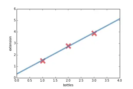

Rendered as a plot we see:
socks fit
While this looks decent, I'm troubled by the fact that it doesn't line up well with the zero point extension of the sock, also we were only able to take 3 measurements since with the addition of the 4th bottle, the binder clip gave way.
Regardless of the questions of hookian reliability of the socks, to weigh your nephew at around 30 lbs, you would need something like 25 nearly identical socks, or calibrate all of them individually, and figure out a way to reliably afix your nephew to the socks. Due to the impracticality of the method, I can't recommend this approach, though in the interest of science, and so that others need not follow in my footsteps, I've shared this failure here.
