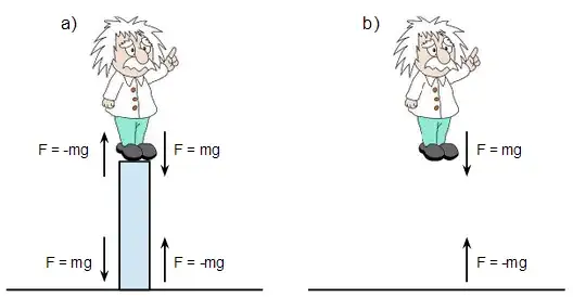

Suppose you're standing on a box as shown in (a) below:
Third Law
There are four forces acting. You apply a downward force $mg$ on the top of the box, and by Newton's third law the box applies an upwards force $-mg$ on you. The box transmits your force to the ground, so the box applies a downwards force $mg$ on the ground and the ground applies an upwards force $-mg$ on the base of the box.
So far so good. But how suppose we suddenly pull the box away as in (b). There is still a downwards force $mg$ on you, and indeed that force is going to make you fall downwards. The question is whether there is an equal and opposite force upwards.
The answer is that yes, there is indeed an equal and opposite force of $-mg$ on the Earth, so Newton's third law still applies. The confusion arises because we normally think of the action and reaction force as operating at the same point. So in (a) there is an equal and opposite pair of forces at the top of the box and another equal and opposite pair of forces at the base of the box. But now we seem to have the action and the reaction separated in space.
With Newtonian gravity you just have to accept that there is a gravitational field in between you and the Earth, and this field transmits the force on you to the ground and the force on the ground to you. To really understand what's going on you need to understand general relativity. This tells us that the Earth curves spacetime and this creates the downwards force on you, however your mass also curves spacetime and this creates an upwards force on the Earth.
