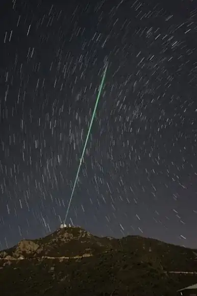

Actually common laser pointers used by teachers and lecturers are less than 5mW. The farthest distance to see their lights is about dozens of meters. But the laser pointers used by professional and amateur astronomers are much more powerful. You can see the light path caused by Tyndall effect directly as below image(source, though this impressive light path is not generated by a handheld pointer, the scence is similar.)
At Mount Hopkins in Arizona, a bundle of five lasers is shot into the atmosphere to improve the imaging of the 6.3-meter MMT telescope
The energy reduction is mainly caused by Rayleigh scattering, which is relatively small compared with laser's intensity. So the beam can easily reach several miles away with the power higher than 50 mW.

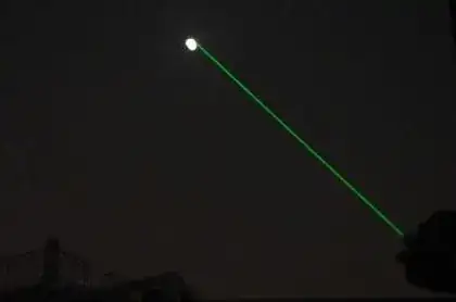

Update: Georg insist the previous image can not be used to discribe laser pointers. So I add another real pointer picture here. But I have no feeling about distance with this one.
