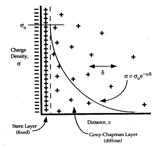

To be be painfully explicit about this, let us reflect that the Debye length quantifies the distance from the surface where you have notable charge buildup. This is determined by balancing the charge buildup effects with the electric field. This length is small, and it has nothing to do with current or AC frequency or anything like that. It is just the distance over which the surplus surface charge is smeared.
Here is an illustration of the Debye length:
Debye

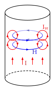

Compare to the skin effect, where the current is forced to flow in the regions of the wire closer to the surface. This is caused by a combination of eddy currents, an induced magnetic field, and the effect on the flow distribution by the changes in that electric field.
Here is an illustration of the skin effect:
skin effect
These are two very different things. If you get nothing else from my answer, you can still look at the two different diagrams and say "those use different physical concepts". The first one uses electrostatics and conduction band quantum effects. The second one uses eddy currents and changing magnetic fields.
