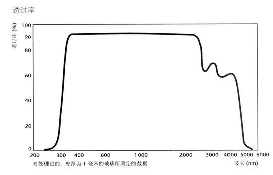

That aside, materials typically have certain ranges where they absorb light more strongly than others. There is no hard and fast rule for this, but if you google "absorption spectrum glass" you will hit tons of pictures, including the following one for borosilicate glass:
this shows a nice flat transmission "window" from about 300 nm to about 2200 nm, covering the near UV to the infrared. This means you would see the glass as colorless, but that doesn't mean all wavelengths get through - just the ones you can see.

The cornea will be damaged by UV. Have you ever heard of snow blindness? The intensity of sunlight in the presence of snow (lots of reflected light) can lead to "sunburn" of the eyes. That's what Feynman protected himself against, presumably (see the above plot - glass typically absorbs in the UV).
