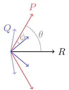

But not all is lost. Poisson offered an alternative proof of the static case in 1811, which is based on symmetry arguments, dimensional considerations and a uniqueness constraint. I quite like this version. You start by assuming you have two forces of equal magnitude $P$ but different directions, separated by an angle $2\theta$ (The red forces in the diagram). Invoking rotational invariance and symmetry, the resultant $R$ (black) must bisect the two in direction, and its magnitude must be a dimensionally consistent formula of the magnitude of $P$ and the angle $\theta$ alone, or of the form: $$ R = P g(\theta) $$ with some unknown function $g(\theta)$. To figure out the function, Poisson then considers two new problems:
Poisson's Explanation
At the top and bottom, we've set up two new copies of the same task, now adding pairs of forces $Q$ (blue) to create the $P$s, and can see that $$ P = Q g(\phi) \implies R = Q g(\theta) g(\phi) $$ Meanwhile the two inner $Q$ forces (slightly darker blue) and two outer $Q$ (slightly lighter blue) forces set up the same scenario, all four of them adding to the resultant $R$, and each pair a part, and since we assume that forces in the same direction just add in magnitude, we have also $$ R = Q g(\theta + \phi) + Q g(\theta - \phi) $$ together: $$ g(\theta) g(\phi) = g(\theta+\phi) + g(\theta-\phi) $$ the only solution to this functional equation are solutions of the form: $$ g(\theta) = 2 \cos (\alpha \theta) $$ with an unknown $\alpha$, but we can fix $\alpha = 1$ by requiring that equal forces in opposite directions cancel. So finally we recover the force addition formula for equal magnitude forces: $$ R = 2 P \cos \theta $$ cast in polar form. From here it is easy to generalize to the full vector addition results by decomposing forces into various pieces.
I'm quite fond of this proof as it relies only on symmetry and dimensional considerations, and is completely free from any discussion of dynamics. But, some people equate this to a deficit:
