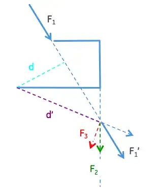

You can translate a force F along its vector (line of action) without changing the torque. For example, you can slide $F_1$ all the way to the vertical member - the one that force $F_2$ acts along.
Now if you look at the diagram I drew:
you can see two different ways to compute the torque.
Method 1: Extend $F_1$ along its direction, draw the perpendicular line to the origin (in turquoise), multiply. The answer is $F_1\cdot d$.
Method 2: Extend $F_1$ until it intersects the line of action of $F_2$. Now decompose it along perpendicular directions - one orthogonal to the radius vector to the origin, and one along it. I labeled the perpendicular component $F_3$ (red). Now the vector $F_2$ that you need to compute is given by looking for the reverse projection of $F_3$ along the line of action of $F_2$. I hope it is clear from the diagram. This is obviously a roundabout way to construct it. It would be quicker to compute torque according to the above, then just set $F_2 \cdot (x_1 + 1) = F_1 \cdot d$.
Note - it may be that you intended to show $d = x$, but that is not clear from the diagram. And if that is indeed not the case, then you need to know the angle of $F_1$ in order to solve this problem - you imply that you do know that. Even so - as presented your problem cannot be solved unless we can compute $d$ for which we need the height of your turquoise shape, or the angle of the dotted line $x$.
