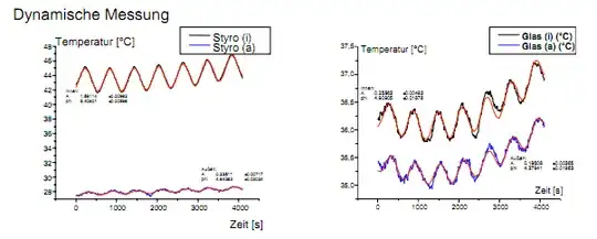

In one of our first physics lab we did an experiment to characterize the thermal properties of a simulated house (it actually was a box with 4 sides made of different materials).
One just periodically heated the inside to 50 degree celsius. The temperature time series on the outside wall will be damped and phase shifted relative to the inside.
I googled "praktikum thermohaus periodisch" and came up with this description: http://www.uni-jena.de/unijenamedia/Downloads/faculties/physik_astro/phys_gp/V_210_1.pdf
And conveniently there is also a students protocol with some data: http://www.personal.uni-jena.de/~p1erra/physik/protokolle/seite%20129-%20versuch%20210.pdf
The following image displays the dynamic temperature data. It indicates how the insulating properties of Styrofoam are superior to glass.
I don't see a reason why this shouldn't work with a real building.
