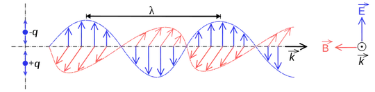

I guess you have this image in mind: enter image description here
This hods just for a single photon, or elementary packet of light. An unpolarized beam of light contains a bunch of photons with many different polarizations. The total electric field will randomly jump all around, still the interactions with matter typically involve a single photon at a time. This means that if you ride the beam, you are allowed to look at the photons one by one, each time seeing a different, but consistent with itself, oscillating field.
