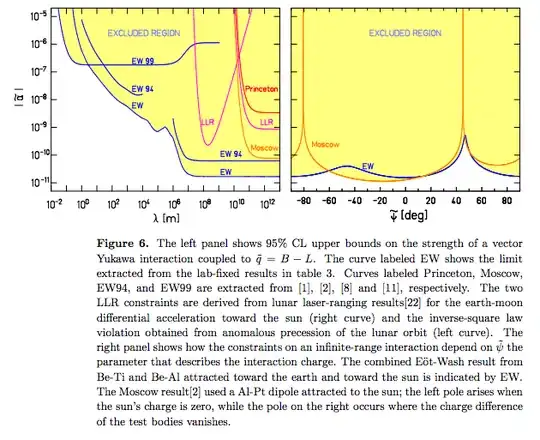

Their tests give bounds on the possible strength of a yet undiscovered force $|\alpha|$ measured with respect to gravitational strength
For instance in Torsion-balance tests of the weak equivalence principle Class. Quantum Grav. 29, 184002 (2012) we see some of the limits on large length scales.
Eötvös limits on long length scales
where here the strength of interaction is measured with respect to gravity.

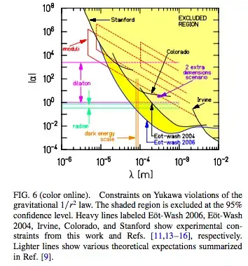

An earlier paper: Tests of the Gravitational Inverse-Square Law below the Dark-Energy Length Scale. Phys. Rev. Lett 98, 021101 (2007) gives bounds for small length scales:
Eötvös limits on small length scales
Again with the strength of interaction measured with respect to gravity.
