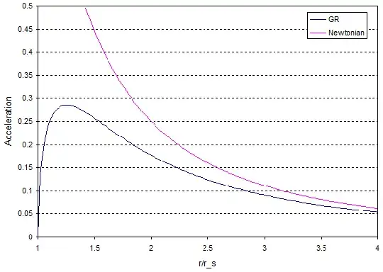

So the force you would feel is actually less than you'd expect from Newtonian gravity and indeed the force goes to zero as the weight approaches the event horizon. To illustrate this I've graphed the force you would feel compared to the force predicted by Newton's equation:
Force on weight
The force is in units of $GMm$. At distances of around four times the event horizon radius and greater the force is similar to the one calculated by Newton's equation, by as the weight approaches the event horizon the force you feel peaks around $1.4r_s$ then falls to zero at the horizon.
