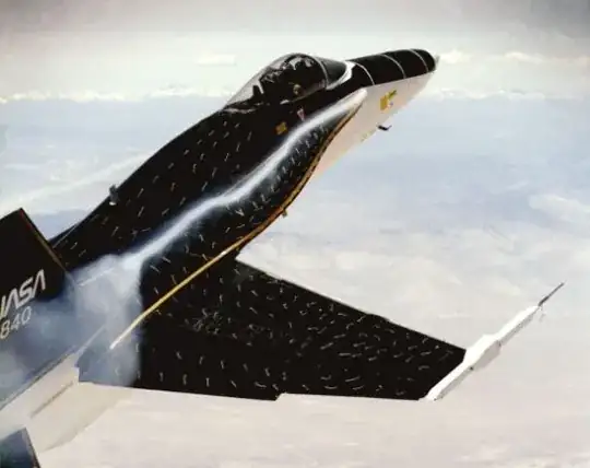

One of the classic stories in the annals of aerospace engineering is the development (and subsequent redesign) of the F-18 and its Leading Edge Extensions (LEX) due to fatigue problems, problems that were ultimately traced to the poorly-understood process of vortex bursting. This aptly named phenomenon is characterized by rapid increases in vortex diameter, mixing, and turbulent kinetic energy.
As a vortex travels downstream, it enlarges and becomes weaker. If the rotational velocity of the vortex drops low enough, the increasing pressure within the vortex causes it to lose its tornado-like structure and break apart. This bursting behavior was found to occur just ahead of the F-18 vertical tails. The resulting air flow impinged directly on the tails causing severe buffeting and structural damage. (Aerospaceweb)
