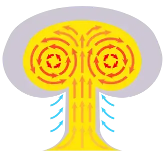

The physics of a mushroom cloud due to an explosion are described in this Wikipedia page. enter image description here
To summarize: the explosion causes a massive fireball above the ground which rapidly floats upwards like a hot air balloon. The internal motion of the fireball causes a vacuum effect which draws dust up from below causing the stalk of the mushroom.
As to the second part of your question - There is nothing special about a nuclear explosion in this respect except its scale. For example this Youtube video includes a 500 tonn TNT explosion clearly forming a mushroom cloud.
