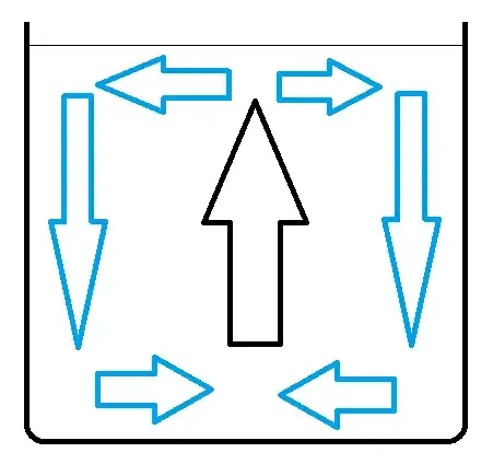

It is because of convection effect. Convection is fluid (in our scenario) movement driven by temperature difference.
In this case grater temperature difference at the beginning - grater speed of fluid at the end. Fluid is cooling down near dish walls. This causes cooled water to sink faster in this part of dish.
Picture shows water movement in dish in cold environment. Arrows show fluid movement direction. Black arrow shows place where there is no heat exchange with environment. Blue arrows show where fluid is cooling down. Horizontal arrows are not important - fluid is not accelerated in this areas.
Water movement in dish in cold environment. Arrows show fluid movement direction. Black arrow shows place where there is no heat exchange with environment. Blue arrows show where fluid is cooling down. Horizontal arrows are not important - fluid is not accelerated in this areas.

At the moment when water freezes speed of water circulation in A is grater than in B. Grater speed of fluid in dish - grater heat exchange with cold environment. Water circulation momentum causes inertia in (resistance in changing) heat exchange ratio.
