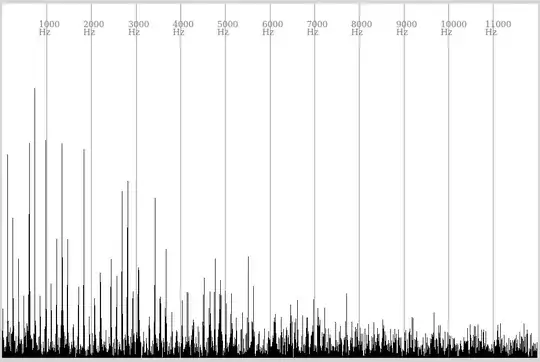

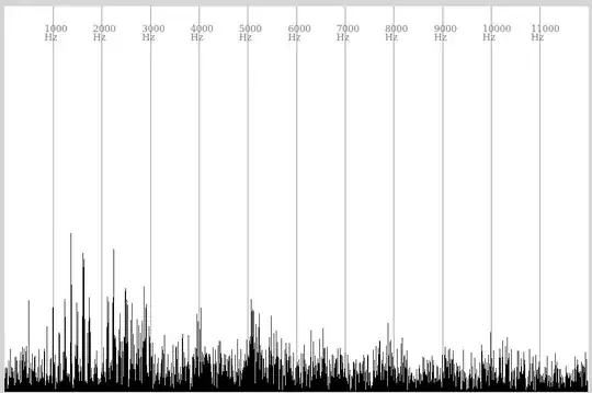

Let's start with the experimental facts. Here are some Fourier power spectra that I recorded of myself singing the vowel "ah" with air (top) and helium (bottom) in my lungs:
power spectrum with air
spectrum with helium
The was with me attempting to do the same thing with my vocal tract in both cases. The two sounds clearly do not differ much in the spacing of the "picket fence" of harmonics, which corresponds to the fundamental frequency. The first (air) has a fundamental at about 126 Hz, the second (He) about 124 Hz. Given the not-so-great quality of the spectra, I would say these are basically the same to within experimental error.
The distribution of power among the different harmonics is clearly different, which explains why the timbres sound so different.
