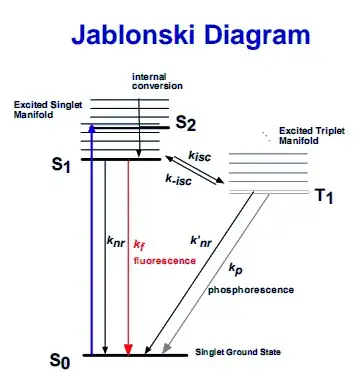

When one excites fluorescence with light (e.g. blue light), the incoming photon pushes an electron into a higher state. Generally one always excites vibrational states (movement of the molecules' atoms) as well. Therefore the emitted photon has lower energy (e.g. green light). The lost energy (internal conversion) heats the solvent or lattice. The shift in frequency (from blue to green) is called Stokes shift.
People plot these energy levels in Jablonski diagrams. I stole this from http://biophys.med.unideb.hu/old/pharmacy/fluorescence_print.pdf Jablonski diagram
