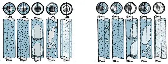

3. Flow Regime Models
Two phase flow is characterised by regimes! regimes
(source: drbratland.com)
It would be best that you use a flow regime map/or observe which flow regime your flow is in and then move accordingly. This is the way I will recommend doing Two Phase flow problems.
You'll have to look for a map that is accurate for your problem and then characterize your flow accordingly.
