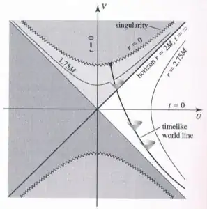

The radial coordinate inside the black hole is time-like, so when you are into the black hole (according to standard General Relativity and considering a Schwarzschild black hole) you are forced to go to the singularity. It's like if the radial coordinate is our usual time coordinate, in which you can't travel to the past.
Kruskal diagram
See for example this Kruskal diagram of the black hole. The maximum speed you can reach is $ c $, that means going on a $ 45° $ line into the diagram. Massive particles are forced to stay into the light cone and they follow $ 0-45° $ trajectories. You can't do better than $ 45° $ and you can't go away from singularity. Moreover, the horizon is the infinite redshift surface (more precisely, the effective infinite redshift surface is slightly outside the horizon, because you don't have an experimental device with infinite sensibility).
