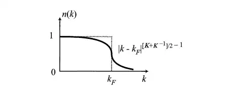

1+1-dimensional Luttinger liquids are examples of 1. No quasi-particle description but with Yes Lagrangian description.
See, e.g. T. Giamarchi, "Quantum Physics in One Dimension" Chap 2.
Fig. 2.4. The occupation factor $n(k)$ of 1+1D Luttinger liquids. Instead of the usual discontinuity at $k_F$ for a Fermi liquid, it has a power law essential singularity. This is the signaturethat fermionic quasiparticles do not exist in one dimension. Note that the position of the singularity is still at k_F. This is a consequence of Luttinger's theorem.

Finally, I don't think I agree with your first example on Luttinger liquids. In fact, they admit a particle description in terms of free massless bosons. In this case I would put Luttinger liquids in the class of theories that admit both Lagrangian description and particle description. Moreover, Luttinger liquids show a strong-weak duality which is the reason behind the fact that even if strongly coupled in terms of fermionic degrees of freedom the theory can be recast as a weakly coupled one in other (bosonic, in this case) variables.
