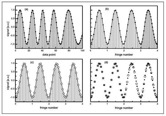

The data from detector 0 was used for calibration. We assumed the laser light consists of a single wavelength of light. We measured however that there were varying frequencies in the intensity. These variations must therefore be caused by flaws in the setup (like faulty calibration or inconsistency in the speed of the stage).
The variations were corrected by moving the data points along the time axis such that a nice sinusoid remained. The frequency of that sinusoid was chosen to be the average frequency of the original data (I am not sure if this is true. We were not told the exact details of the data correction procedure.) To prepare the data for Fast Fourier Transform the data points were moved along the sinusoid such that they were spaced equally horizontally.
Here is an illustration of the procedure:
Data correction procedure

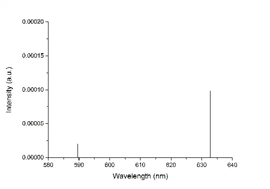

This gave the following spectrum:
Sodium spectrum
Now onto the main problem. How do I determine the spectral resolution of this setup? Spectral resolution is the smallest difference in wavelength the spectrometer can detect at a certain wavelength.

We were told that because the laser peak is sharpest in our spectrum its width gives us the resolution. But I do not understand how these are related. Can someone explain that? If the width of the laser peak does not give the resolution, what would and why?
