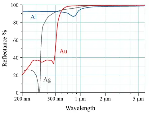

  1. I’ve read that in the past quality mirrors were coated with silver but that today vacuum evaporated coatings of aluminum are the accepted standard. When I look at the reflectance vs. wavelength plot,
I see that silver has a higher reflectance than aluminum. So why use aluminum instead of silver? If one wants the highest quality mirrors I assume that cost is secondary, so what is the physics that I am missing here?

Johannes makes a good point about durability. As a footnote, I'll add that aluminum has another nice property over silver, at least as far as your plot shows: constant reflectance over the visible spectrum.
Look at the slopes of the lines from $400\ \mathrm{nm}$ to $700\ \mathrm{nm}$ - silver varies from $80\%$ to $95\%$ reflectance, while aluminum stays between $90\%$ and $93\%$. So yes, a primarily red image will be slightly dimmer in aluminum than in silver, but all images are slightly reddened (the blues are suppressed more heavily than the reds) in silver, whereas aluminum gives a more faithful representation of the colors. (Plus primarily blue images will actually be darker in a silver mirror than an aluminum mirror.) For everyday use, it's easy to compensate for a darker image (just light up the room more), but not so easy to compensate for an image that has the wrong colors.

Nobody has yet mentioned the one aspect of silver that the graph depicts. Silver absorbs strongly near 315 nm. If you were interested in UV light from the stars, you would have a hole in your data (between 310 and 320 nm) if you used silver. Not only that, any light gathered with a wavelength less than 310 nm would require longer acquisition times.

The reason for going with silver rather than aluminium is a slightly improved reflectivity in the near- and mid-infrared (99.1 per cent at 10 microns), but also that the emissivity of the silver coating is around 38% that of aluminium, which reduces background in infrared observations.
The paper reports on durable coatings that reduces the tarnishing that favours an aluminium coating (as well as aluminium's superior performance shortward of 400nm). I guess that these are rather expensive, so aluminium is still the norm unless you want to be re-silvering the mirror very frequently.
