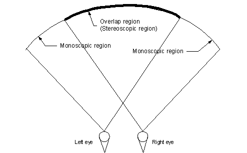

Now, if you ask why the perspective phenomenon happens at all, the answer is this picture:
(source: vresources.org)
As you can see, because the field of view is a triangle (it is the 3D field that we normally focus on), than the distance you can encompass with your eyes is larger the further it is from you. This also means, however, that relative distances get smaller.
