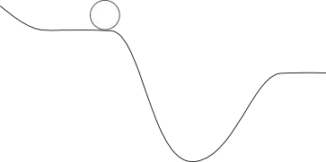

Potential Energy
On the macroscopic scale, we typically only think about gravitational potential energy - the field responsible for the force of gravity. We are used to thinking about objects that are high above the earth's surface falling towards the earth when given the opportunity. If I show you a picture of a rock sitting on the surface of the earth:
Example of a potential energy surface
And then ask "Where is the rock going to go?" you have a pretty good idea: it's going to go to the lowest point (we are including friction here).
