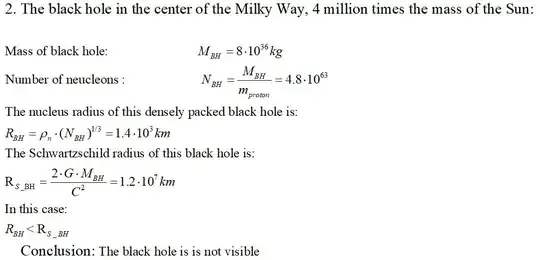

The question now is how come that black holes are not directly observed, while neutron stars are observed. My answer is: The visibility depends on the relation between the physical radius of the nucleus and Schwarzschild radius. If a celestial body has a nucleus radius that is bigger than its Schwarzschild radius, it will be observed. On the other hand, if a celestial body has a nucleus radius that is smaller than its Schwarzschild radius, it will be hidden. This is exemplified in the following calculations:

1) A black hole is basically a neutron star. Like a neutron star (and also the nucleus of an atom) it is compressed to the maximum density possible in the Universe. 2) A black hole must have a mass that is bigger than ~5.25 Sun masses. At this mass the physical radius of the black hole is smaller than its Schwarzschild radius. 3) It is possible that the temperature of the black hole is higher than the temperature of a neutron star. However, this temperature cannot be measured by an observer outside the Schwarzschild radius. 4) It can be shown that the gravity of the neutron star and the gravity of the Milky Way’s black hole are of 2x10^12 m/sec^2 and 2.6x10^14 m/sec^2 respectfully. 5) The physical conditions of 3) and 4) show that a black hole cannot be a portal to other Universes.
