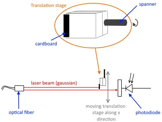

Ok, so since your reasoning seems to be ok, the real question is : "How can one measure experimentally a laser spot width?".
In your case, since you are using a gaussian beam, an equivalent is "How to measure the waist of my laser?"
If you are working in a wealthy lab, the simpliest way seems to buy and use a CCD camera. Otherwise, an other "easy peasy lemon squeezy" (and cheaper) method is possible.
For this, you will need :
  • a linear translation stage (for optic tables) with a graduate spanner
  • a photodiode
  • a piece of black cardboard
Step 1 : Align the photodiode with the laser.
At this point, be sure to get the maximum power from your laser.
Step 2 : Attach the piece of cardboard on the translation stage.
This blocks the laser light so that it can't reach the photodiode.
Step 3 : Place the all thing between your fiber opening and the photodiode.
Step 4 : Move the translation stage with the spanner and measure the power collected by the photodiode in respect of the displacement (using the graduation).
Since your beam is gaussian, what you expect is an error function because the power that you are measuring is simply the integral of a gaussian... $$\mathcal{P}\sim\int \exp \left[ - \left(\frac{2(x-x_0)}{w}\right)^2 \right] \mathrm{d}x\;\sim \mathrm{erf}\left(\frac{x-x_0}{w/\sqrt 2}\right)$$
where $w$ is the waist.
Step 5 : Use your favorite software and do a fit. Then you have $w$.
Note that this method is not that precise. But it gives a good order of the waist, thought.

I agree with dolan's answer with a few modifications.
Firstly, the CCD method is a good way to do this, but only if you are careful not to saturate the camera and FIT THE RESULTS don't just estimate a size from an image. Although the spot may have an apparent size in the image, the apparent size will be completely dependent on the contrast of whatever display system you are using.
I prefer the other method. However, I would not use a black piece of cardboard because lighting fires in an optics lab is a bad idea (black=absorbing; cardboard=flammable) and because the edge of a piece of cardboard is not very well defined on the micron scale. Instead I would use a razor blade. It has a sharp edge and it will not light on fire. If you start ablating the razor blade like I have in the past, you will get very wonky results. The only way I found to solve this problem is to use something thicker and take the hit on the accuracy of the spot size measurement. If anyone has a better solution I'd love to hear it.
