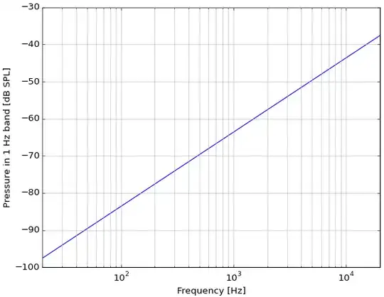

This equation also lets us calculate the spectral density, which seems to be violet noise, increasing by 6 dB every octave, same as the underwater reference in the question:
It's violet noise apparently
