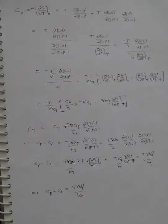

The given proof entirely use Jacobian techniques. Maxwell relations are also used in Jacobian from
