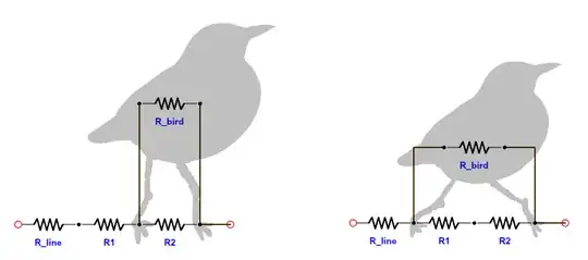

Here is a circuit representing the system. $R_{wire}$ is the resistance of the section of wire between the bird's legs. $R_{bird}$ is the resistance of the bird (which you can measure by sticking the two probes of the multimeter to the bird's two feet - if the cable is insulated, you will have to add the resistance of the insulation as well).

A critical factor is the ratio of the resistance of the bird's body $R_{bird}$ to the resistance of the section of wire between its 2 legs $R_{wire}$. First let's consider the the effect of opening legs on total current.
With legs closed, we get total resistance of the power line $R_{closed} = R_{line} + R_1 + \frac{1}{\frac{1}{R_2} + \frac{1}{R_{bird}}}$. With legs open, $R_{open} = R_{line} + \frac{1}{\frac{1}{R_1 + R_2} + \frac{1}{R_{bird}}}$. $R_{closed} > R_{open}$ (intuitively, you are replacing more of the wire with a more conductive bird/wire composite module). Accordingly, the total current through the whole power line will be higher when legs are open $I_{closed} < I_{open}$.
Furthermore, as Ilmari Karonen pointed out, increasing $R_{wire}$ increases both the potential experienced by the bird and how much of the (now higher) total current "splits" off into the bird part of the circuit.
If the bird increases the distance between its legs hundredfold, the increase in total current on the line will be negligible. $V_{wire} = V_{bird}$ will go up hundredfold, and correspondingly, the bird will experience hundredfold-stronger current. However, for a normal bird, if we repeat our original analysis we will find that even 100 cm of cable still has negligible resistance compared to a bird, so I doubt real birds would notice a difference.
